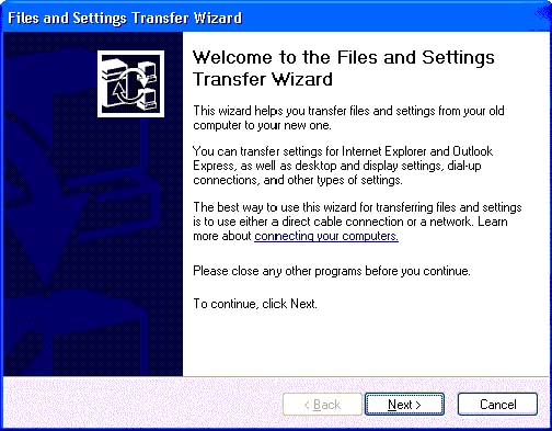

The first window that appears is the Welcome to the Files and Settings Transfer Wizard startup window.
From here you would select NEXT to continue. The next screen that appears is the WHICH COMPUTER IS THIS screen, where you would select either NEW COMPUTER, where you would want to transfer your files and settings to, or OLD COMPUTER, which is what you would select if the system you were working on was where the current files and settings are that you want transferred.
