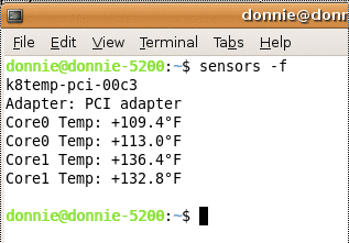

The first time you run the “sensors” command, you may be prompted to let the program detect your motherboard's sensors, and configure the proper kernel modules. After that, “sensors” will give you information about CPU temperature, and for some motherboards, overall system temperatures and fan speeds. (The output from each motherboard is different, so you would probably have to modify the following procedure somewhat to fit your own needs.)
To see system temperatures, just enter the command “sensors” for Celsius readings, or “sensors -f” for Fahrenheit readings.

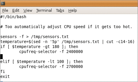

Next, I wrote a script that saves the “sensors” output to a temporary text file, and uses a combination of “sed” and “cut” to extract the applicable information. An “if . . . then” construct will adjust the CPU speed accordingly.
In line 3, the “sensors -f > /tmp/sensors.txt” command will save the “sensors” output to a text file. The next line will extract the applicable temperature information and assign it to the “temperature” variable.
The CPU in this machine is a dual-core model, but for some reason the “sensors” command shows two temperature readings for each core. For some reason, the first reading for “Core1” is always the highest. That reading is on line 5 of the “sensors” output, so that's the one I'll want to use. To see only the contents of line 5, I use the command:
sed -n '5p' /tmp/sensors.txt
The actual temperature reading is in characters 14 through 16 of that line, so I'll pipe the output of the “sed” command into “cut”.
cut -c14-16
Next, I'll use command-substitution to assign the resultant value to the “temperature” variable.
In the “if . . . then” construct, the contents within the square brackets will compare the actual temperature to the test value. Since we're doing a numerical comparison, rather than a text-string comparison, we'll have to use “-gt” and “-lt” instead of the normal greater-than and lesser-than symbols. The “if . . . then” will set the CPU speed down to 2.4 GHz if the CPU temperature rises to above 180 degree Fahrenheit, and will raise it back to 2.7 GHz if the temperature falls to below 100 degrees Fahrenheit. (If you're wondering how the “+” sign affects a two-digit temperature reading, not to worry. The bash shell considers a positive number as either a stand-alone number, or a number with a “+” sign in front of it. Either way, the number is read properly, so we don't have to worry about whether or not the “+” sign is there.)

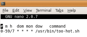

I then saved the file as “too-hot.sh” in the “/usr/bin” directory. Since the speed selection utility requires root privileges, I then set up a cron job for the root user.
sudo crontab -u root -e
I set the job to run every seven minutes. (After some experimenting, I found that to be the ideal interval.)
